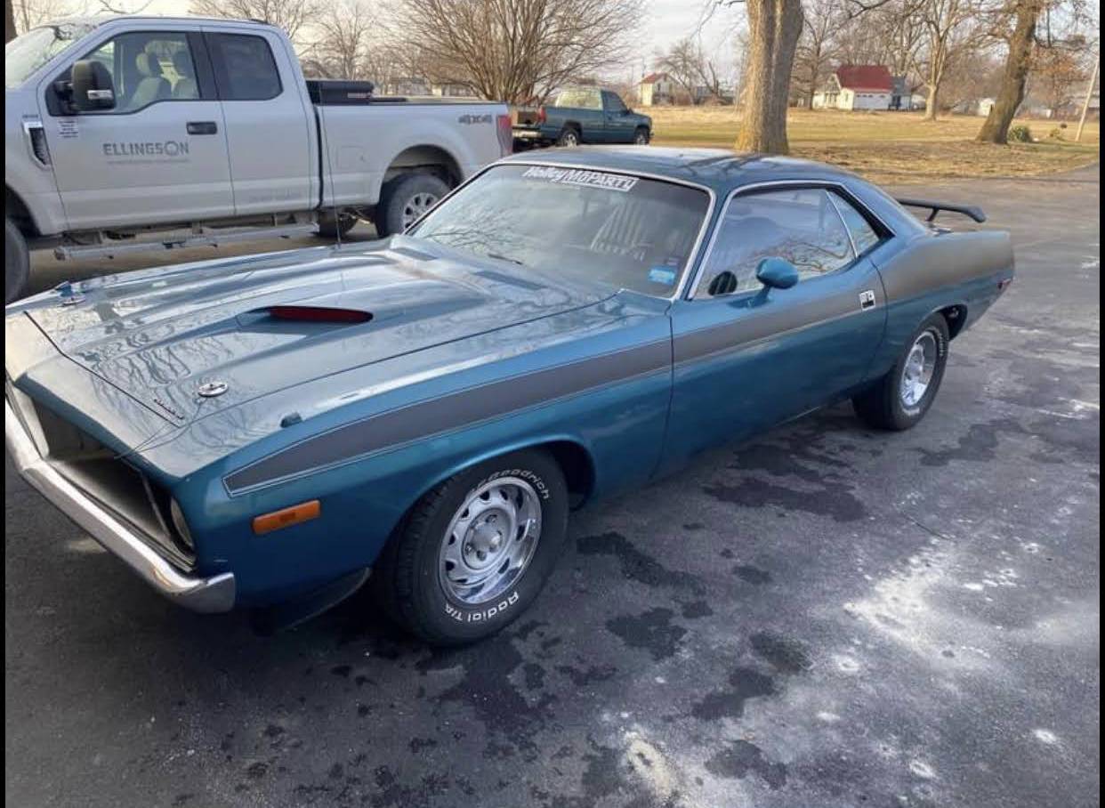

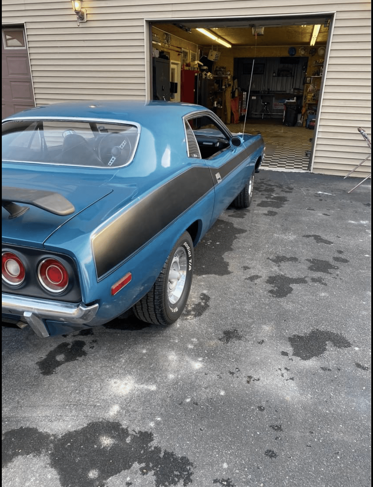

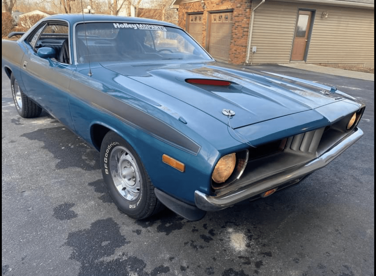

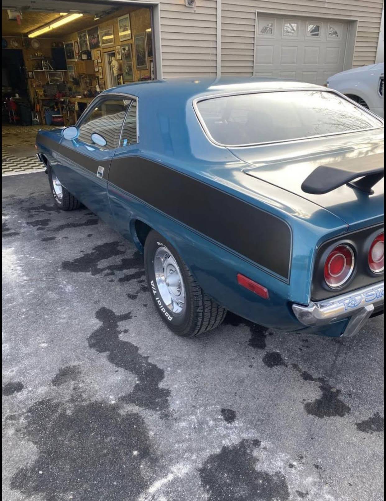

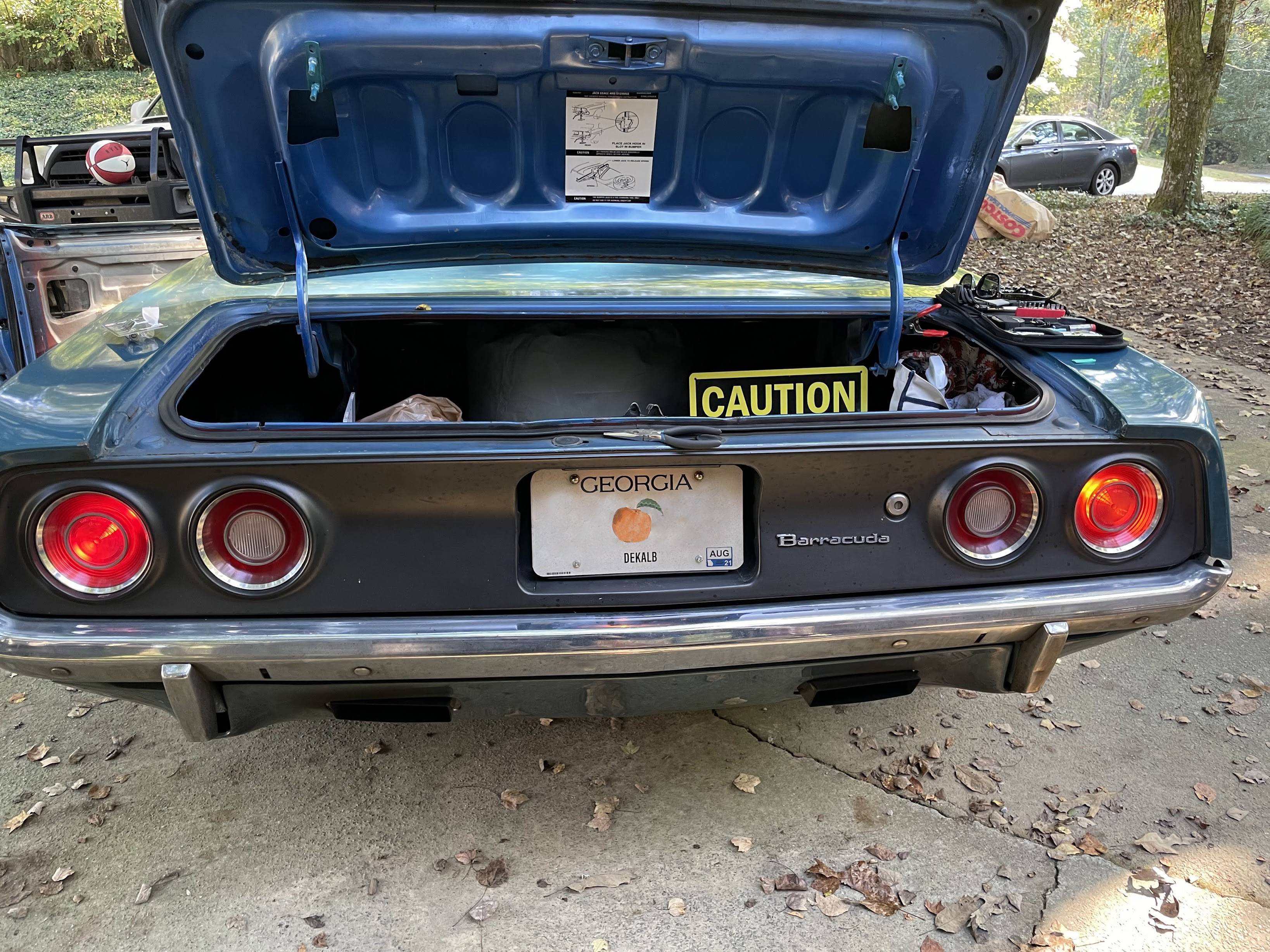

This is kind of my introductory post, and unofficial journal of restoration... Part-time lurker, but it's past time I start participating. I'm a bit late to the party. Little history-- after 2 years of looking, saving, and trying to prepare; I purchased my 1974 Barracuda 318 in February 2021. I found it in Illinois, the gentleman bought it to restore/flip, but decided to let it go and use the funds on bigger projects. He only had it about 3 months so all restoration/modifications had been done by the previous owner who had it for at least 20-30 years... I'm a die-hard AMC fan, but wanted my first project car to be something that was a bit easier to find parts for. The 'Cuda has been one of my favorite cars since I was a little girl and one i always just assumed was financially out of reach. I cannot tell you how much it means to me to have been able to own this car so much earlier in my life than I anticipated.
I'm already well into restoration and modifications of my own this past year, so I'll break things down into a couple different posts in this thread...
In this first post you can see when I first went to see the car and when she got home. A few of the details I knew and determined when I first bought the car::

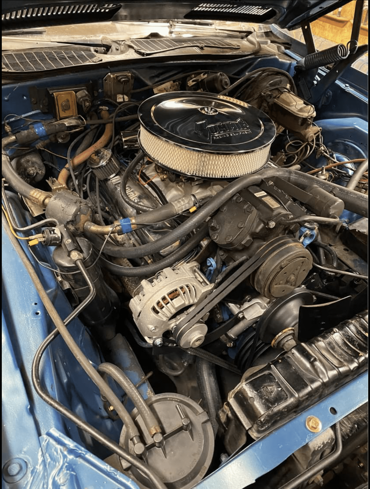

Motor is a non-number's matching 318. Mainly stock, it had an Edelbrock intake manifold, and Edlebrock carb that was WAY too big for it. Missing kickdown linkage.
727 Torqueflite transmission
7.25 Rear end
A/C car
Minimal rust. Few holes smaller than a silver dollar. ((Floor pan, battery tray, etc...)) No major bondo as far as anyone can tell with a magnet. Rust damage around the rear windshield.

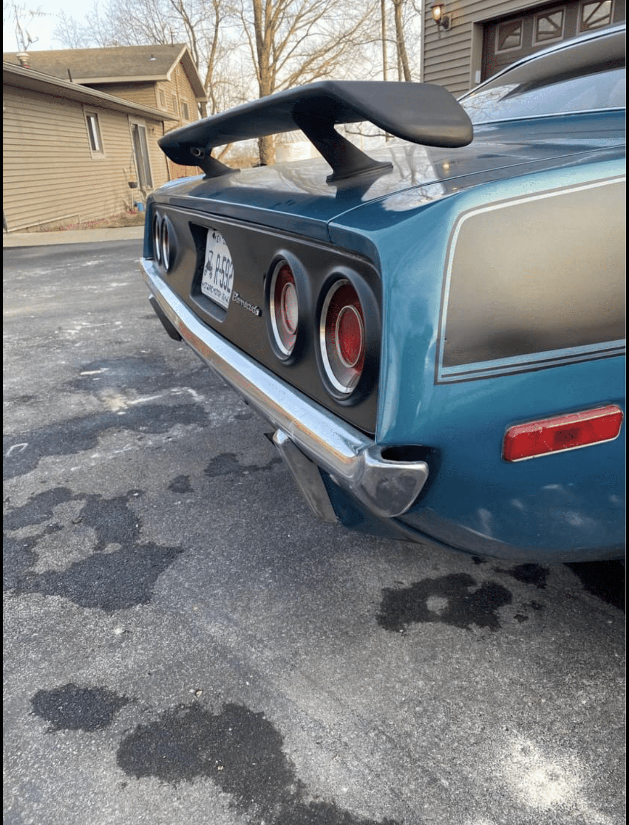

Front and back bumper damage... ((Like they backed into, or drove into the garage wall... Super minor.)) Badly repaired damage on the grill.

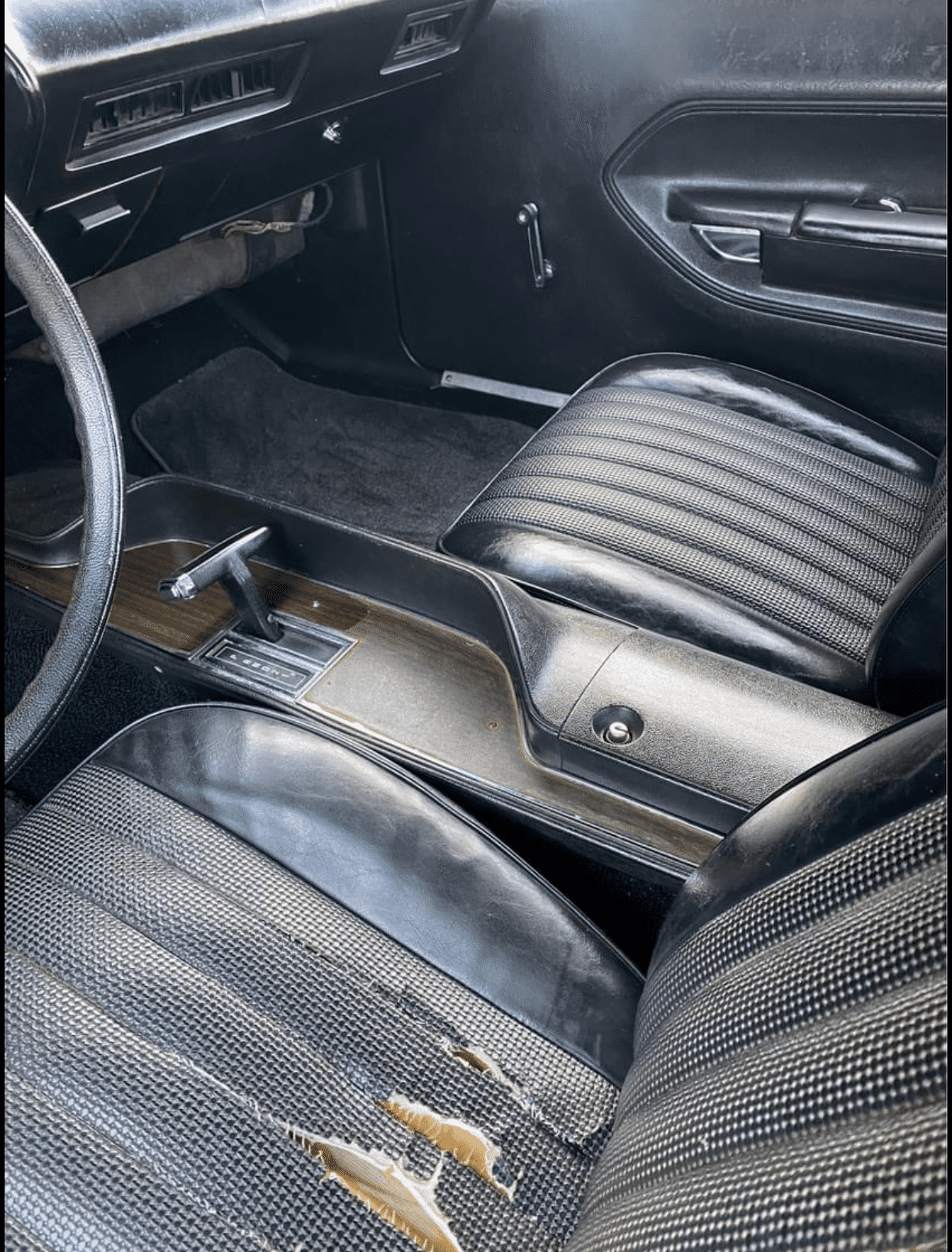

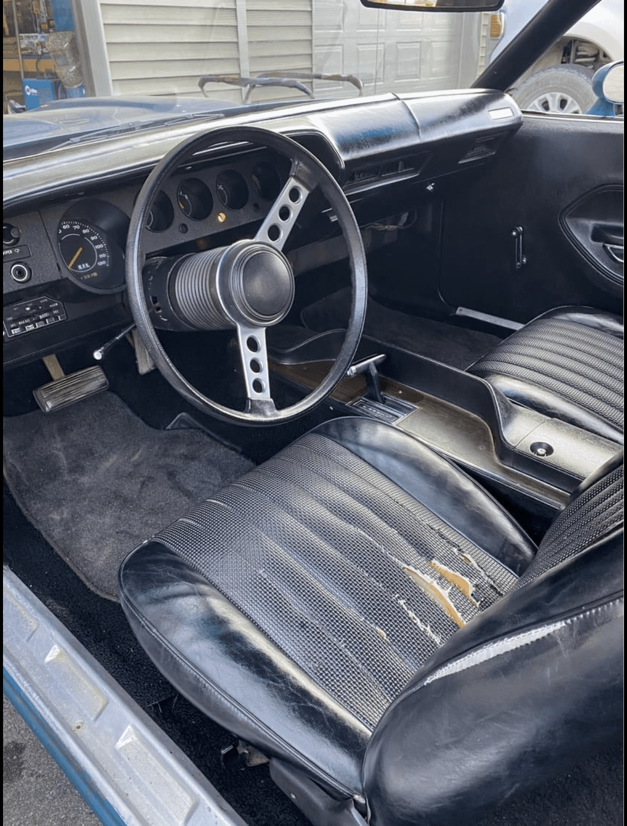

Driver's seat badly cracked and split. Foam is pretty squashed. All other seats in good condition.
Dash badly cracked and the previous owner badly drilled speaker wire over the missing speakers.
Original radio replaced with cheap cassette player
Paint was a backyard job that looks amazing at about 10ft but as a professional graphic artist drives me crazy with color discrepancies, wobbly lines, and terrible color matching....

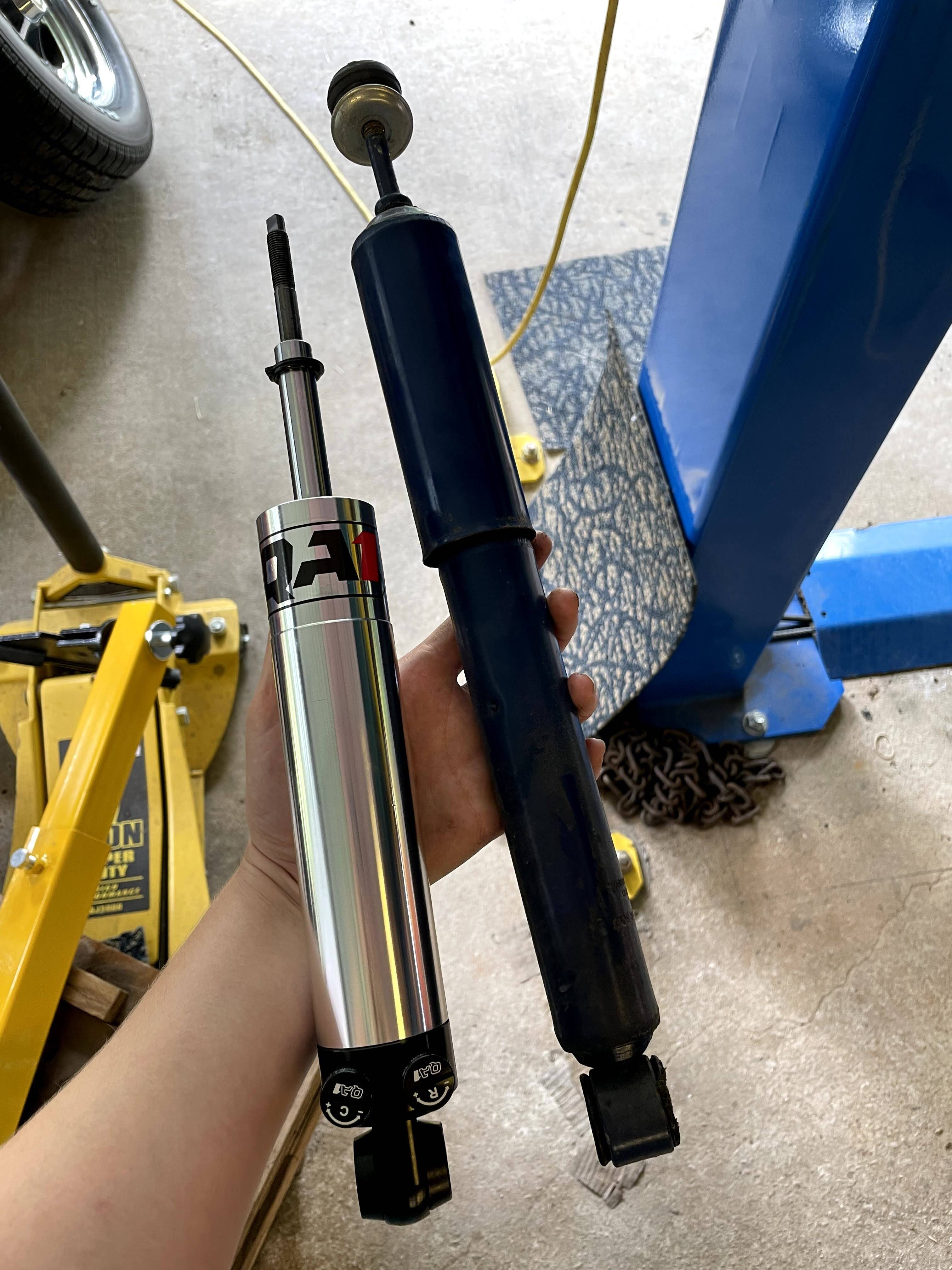

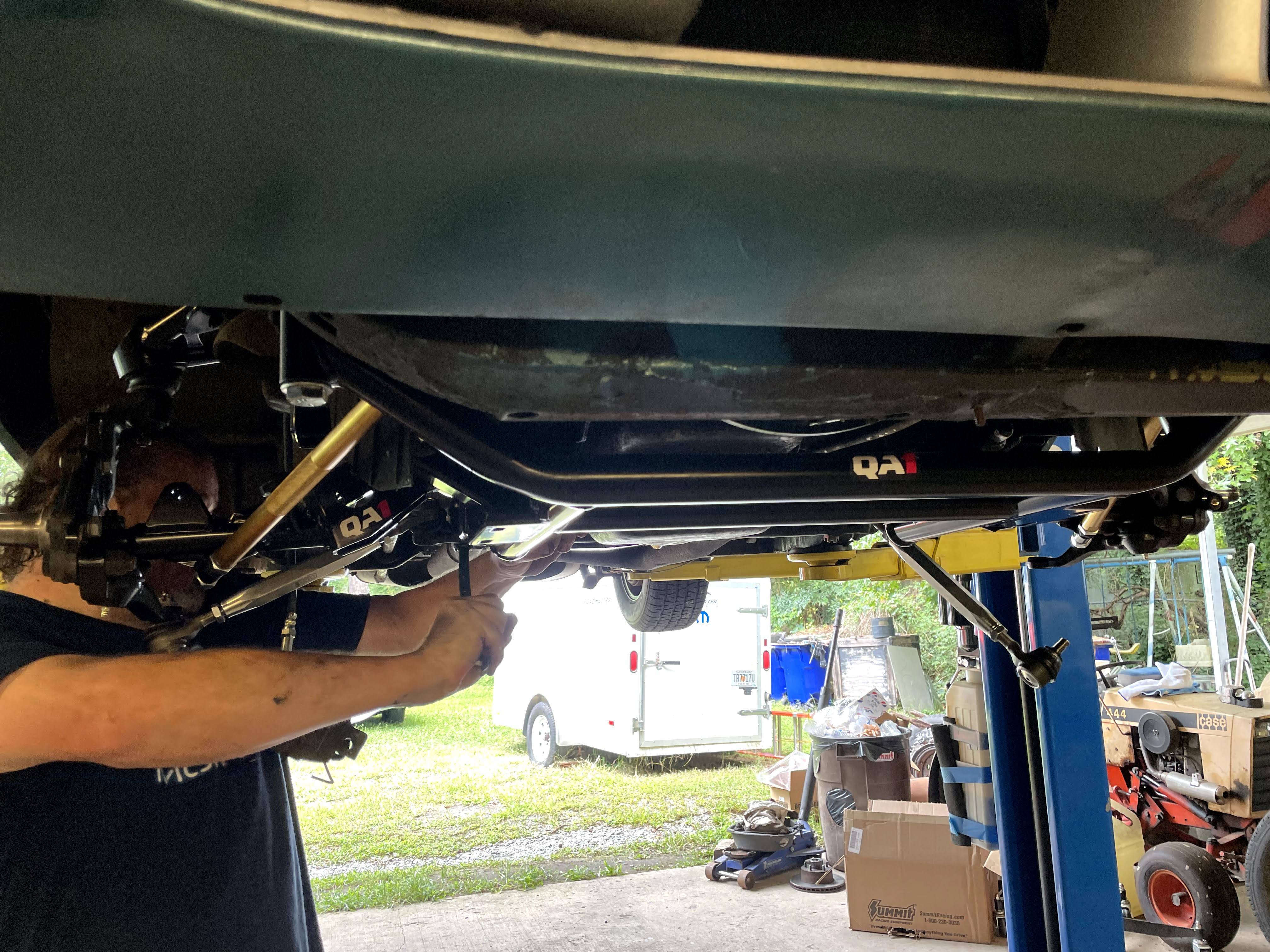

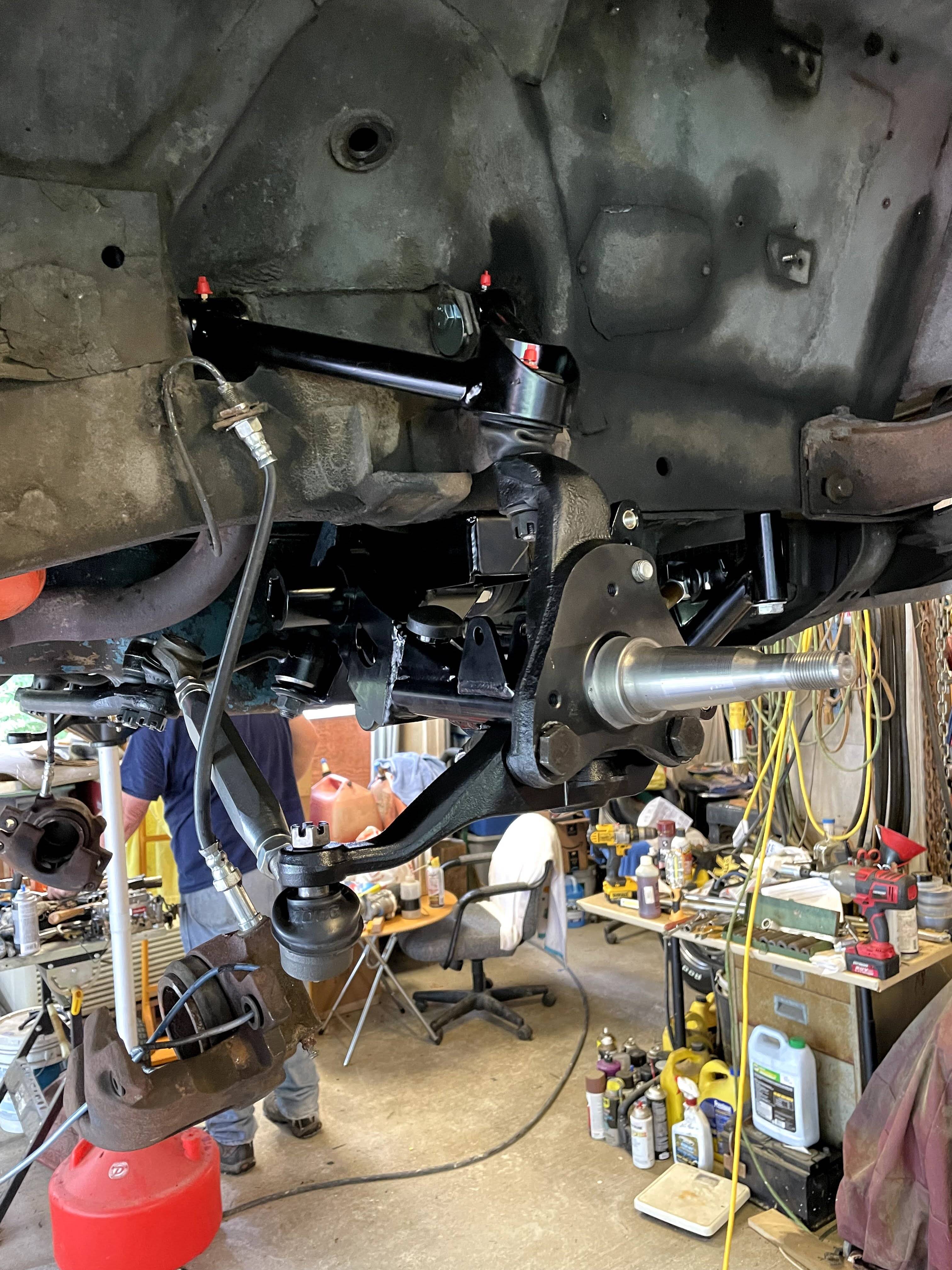

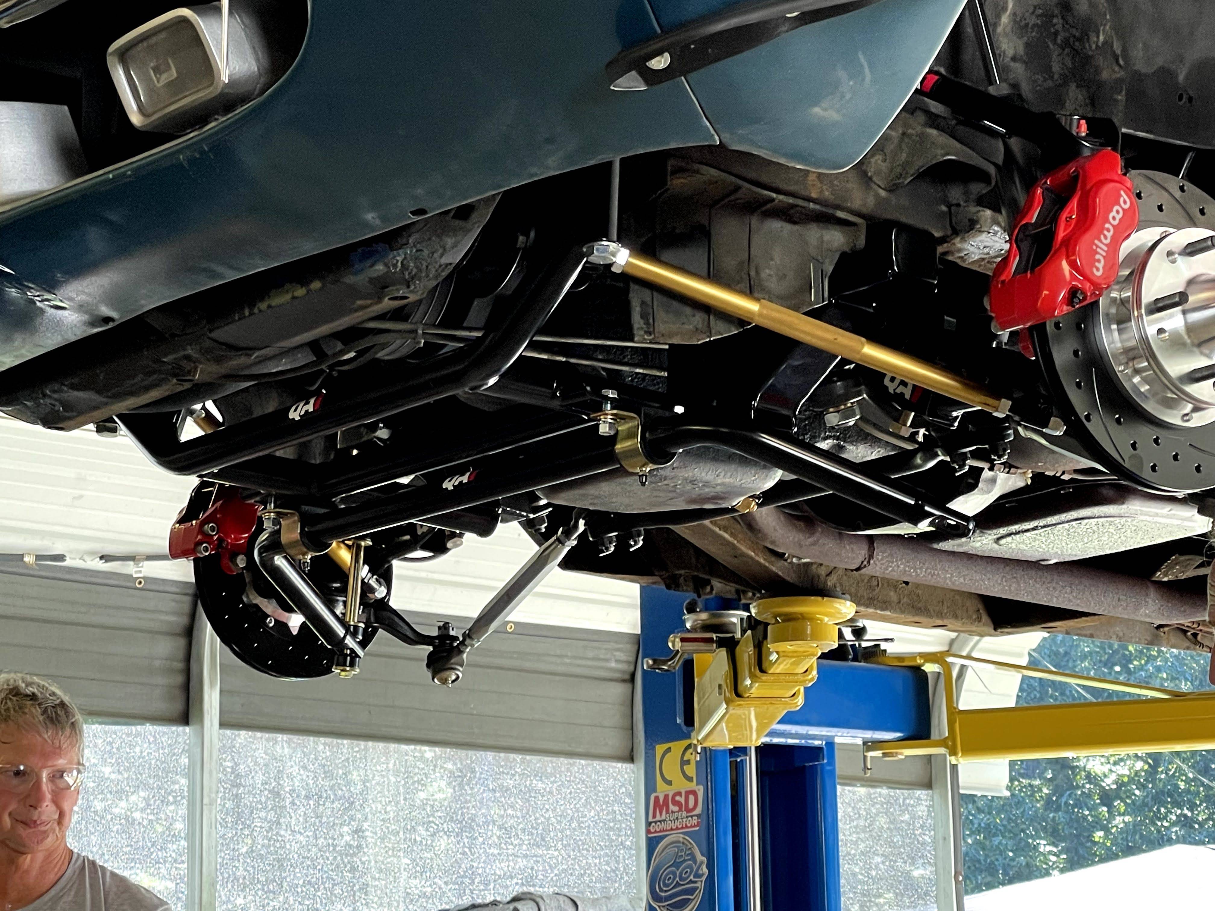

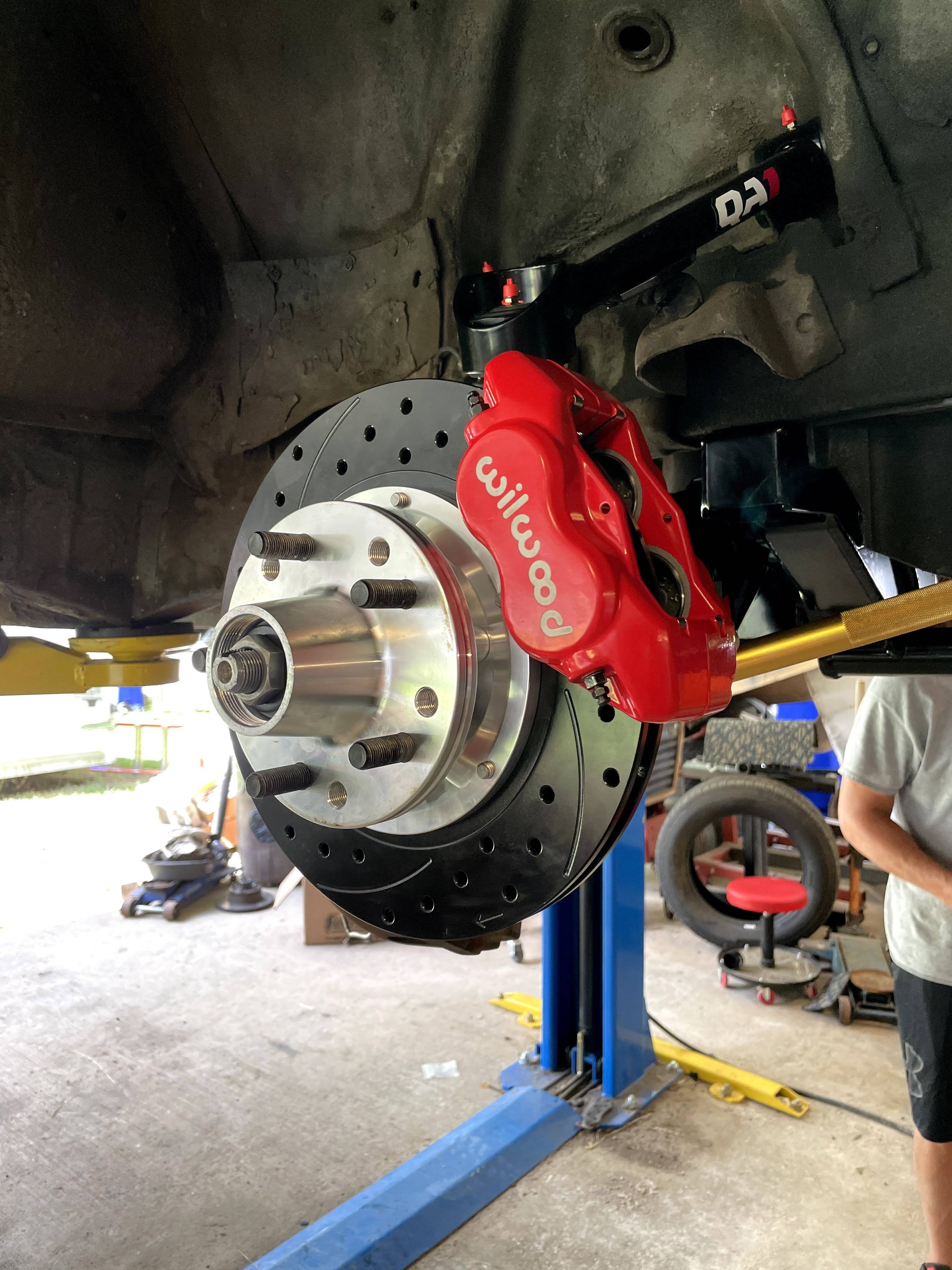

This was the biggest modification I've done so far and the one that needed done the most. Full front suspension replacement and new disk brakes.
Let me stop and first say how much I love and appreciate the friends I've made in the North GA Mopar Club. The people have been so welcoming and the old pros have been so understanding and patient with me in my stumbling around. I'm constantly trying to learn but with no experience, I have very little context to understand the why's of the how's. But everyone lends a hand and deals with my endless questions.
One friend, Steve, Was instrumental in replacing the master cylinder a few weeks prior to doing the suspension so I could get the car safe to drive. But driving was like sitting in a tin can on a wooden rollercoaster... Everything bounced and rattled and banged around... Driving over a road reflector was like hitting a child-sized pot hole!

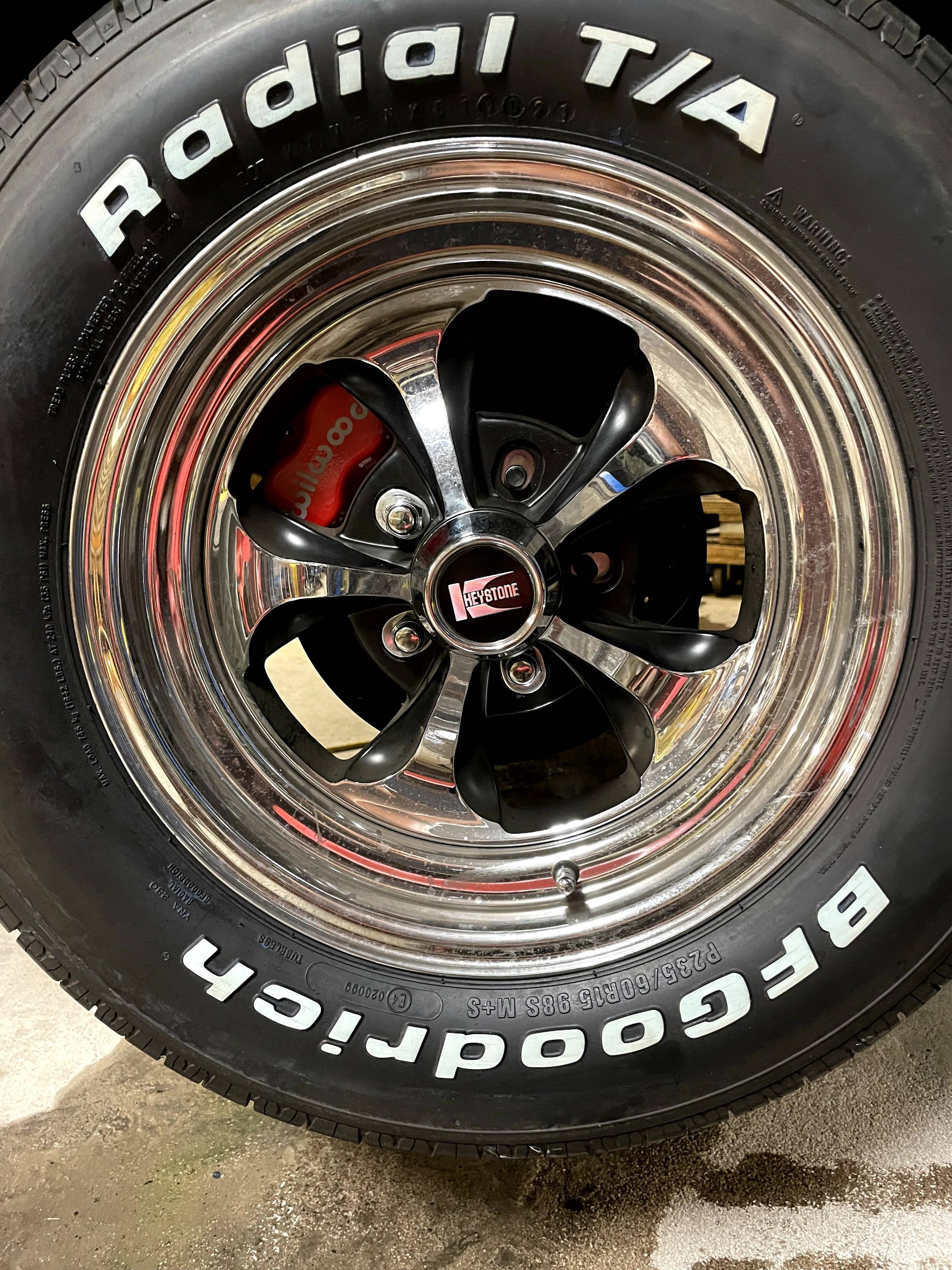

So for my birthday weekend, my friend Lee opened his garage to me to use his lift and with the help of several others, I was able to rip out the old stock suspension and shock and completely replace with a brand new QA1 Handling suspension system. New K-member, pitman and idler arms. I replaced the power steering with a new Borgeson steering box and fluid pump. All new Wilwood brakes and was finally able to upgrade to a set of Keystone Klassic Wheels!!

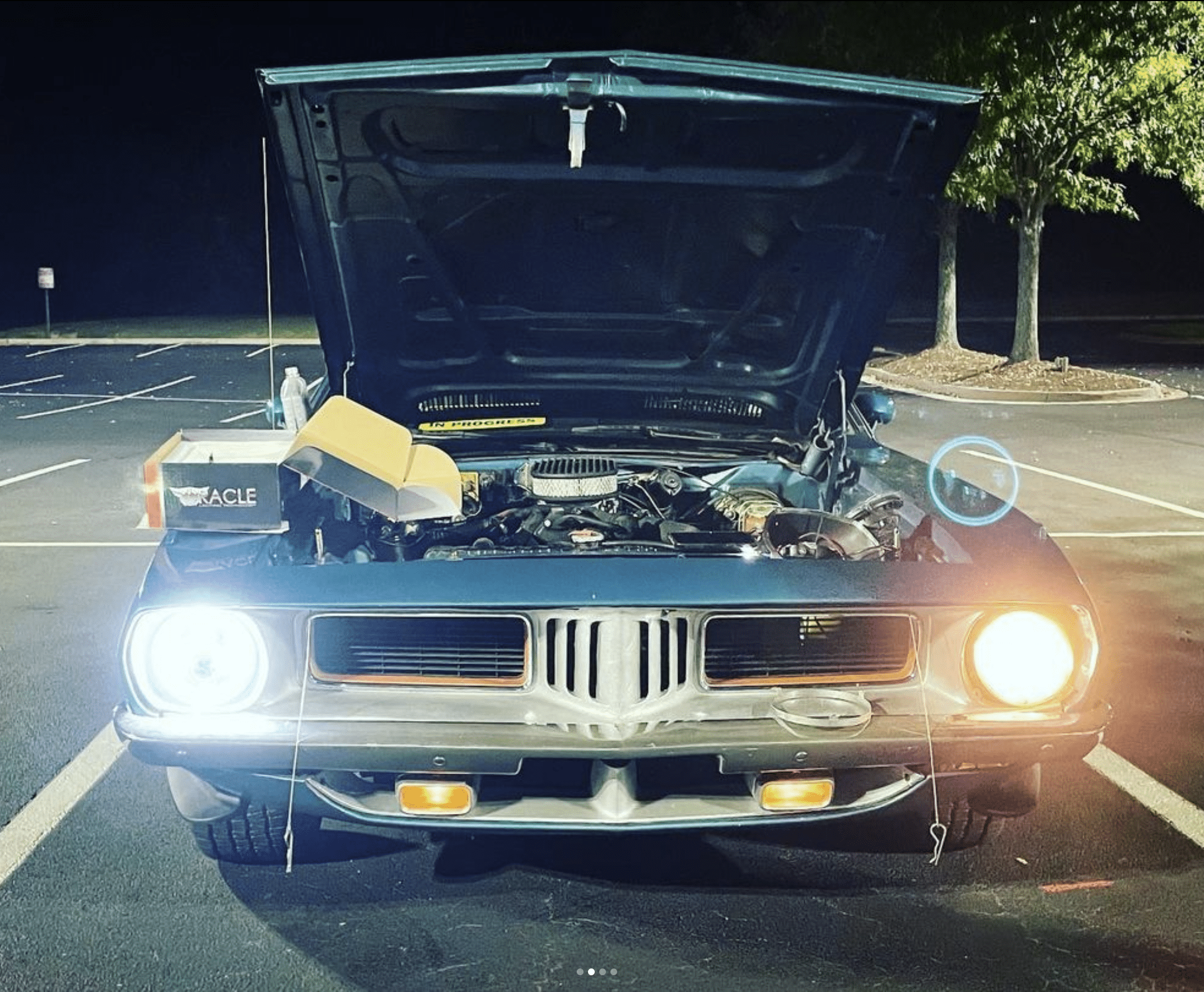

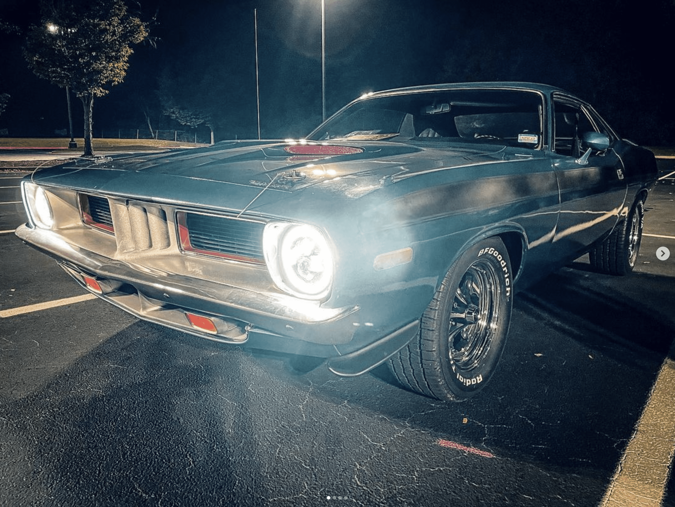

Couple other small projects over a few months. Both practical safety and just vanity. Replaced the normal headlamps with Oracle Halo bulbs and LED bulbs for the tail lights. Wanted to brighten everything up for better visibility. I also learned about having to upgrade relays and that the Hazard relay is not the same as the turn signal relay... ((Electrical systems are NOT my forte...)) I installed the headlamps just as is because it was getting dark and I needed to not spend the night in the Summit parking lot... But the plan is to set up the wiring so the halos will light with the ignition like daytime running lights, and only the LED's will turn on/off with the switch.
